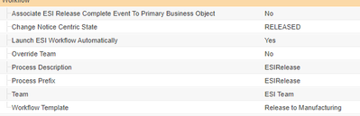

Need help in the following areas:
1. Need guidance in setting the following:
a. How do we specify for a specific Change Notice type and status say 'Released' ESI transactions are generated ?
b. Any documentation around this area is appreciated.
c. Ideally once we setup the Distribution Target, what else do we need to setup for Windchill ESI to work as expected ?

Take a look at ESI Preferences:
SMaran
(To:avillanueva)
Really appreciate your expertise and time!!!. It resolved the issue. Would you know how to set up the ESI output to B2MML schema ?
