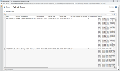

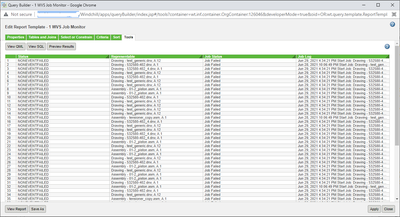

Did you try using the Query Builder?
The image below is a query I built to show the status of all publishing jobs.
Can certainly add more info.  I included the log that you'd see in the WVS Job Monitor for each job.  Probably over kill but interesting to know it's doable.
David
I made this with the Query Builder and also added an action under the Quick Links drop-down menu to the report easy to access.
Not sure which status you are referring to but I've included both of them.
I also included the WVS log just to see what that would look like.  Might be over kill but good to know it's doable.
If you are looking for a count of Job Failed and Job Successful that too should be doable.
I'm not exactly sure what you are looking for but anything should be doable in Query Builder.
David

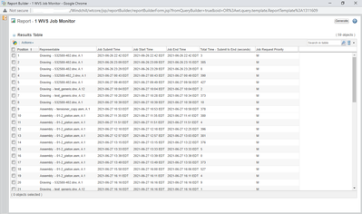

Ideally, we would like to have the user see where their jobs falls within the entire queue,   i.e.  if there is a currently, 300 jobs, and I submit a rep job, I am now at position 301.  But if the user looks up their job monitor, they have 1 job at position 1.  it sets the expectation that the visual will be available soon, but in reality, it could be several hours away.

Daniel,
Now that I know exactly what you're looking for I was able to add some code to calculate the "Position".
FYI, "Position" is not stored in the dB.  It's calculated from data in the dB.
Seems to work well.  See the image below.
David

@STEVEG,
I'm using just one table, QUEUEENTRY.
David
