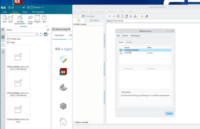

Hi All,
we have got some problem with NX when the WorkgroupManager is on line.
Once the connection server is online NX lost the key to use Manufacturing Part.
The NX properties are ignored about NX Manufacturing template.
Template for part, assembly and drawing are ok. We lost only template for Manufacturing template
Any ideas about it?
Best regards
Gianpaolo

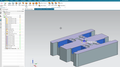

Hi these are the step to compare the different behaviour of NX once connected or not with WGM.

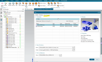

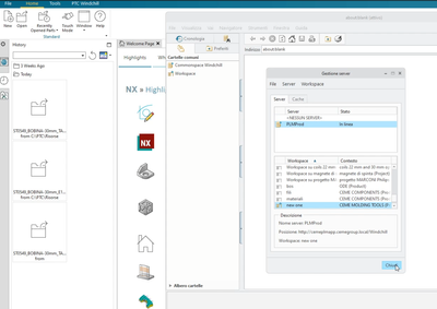

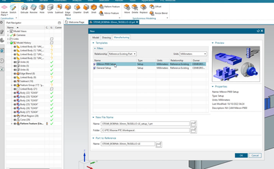

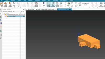

Step8 Setup part is created uncorrect linked .. refereced with some template part.png
The 4th and the 8th should have the same result.
