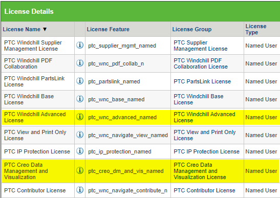

What does your license Management Info page say? For my users, they need to be in the PTC Creo Data Management and Visualization group AND PTC Windchill Advanced License group. Check to make sure they are also not in View and Print License group.

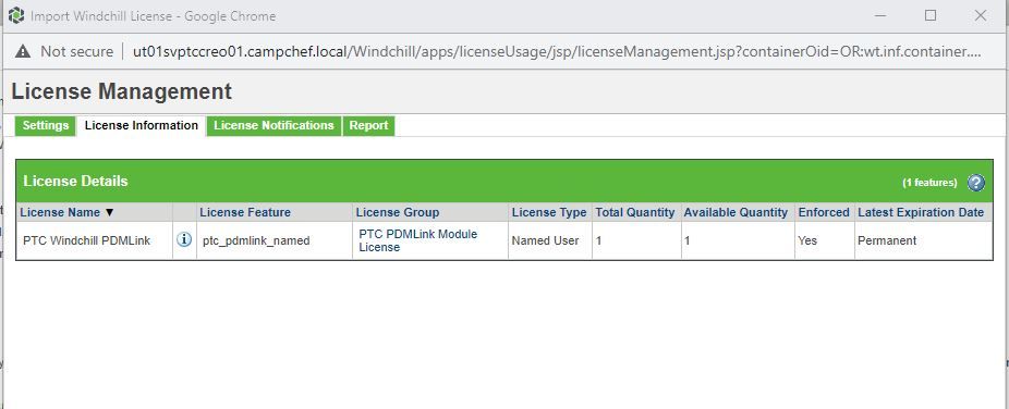

This is all I am seeing in my license details.

I would go back to PTC License management, it looks like your license allocation is not correct. You need a new license file.

The PDMLink Module license should allow CAD interaction, but do you only have one user in your system? You mention CAD Authors in plural. That table shows that you have not applied the license to any user. Be sure to check that your system is properly licensed. Assign one user to that license profile and verify that you are able to interact with CAD.

@buenosroas , right, that is an older license option. Newer license configurations are Basic and Advanced. Its been a while but I remember converting to them but am not sure if this was a new requirement to change. Either way, @bbennett mentioned that he recently updated their license file (download) from PTC. I suspect that the number of licenses were not allocated properly to this system, just a count issue. By putting people as Admins, you've effectively made them gods and part of the license exclusion group. Not a good thing and bad things will start happening to your data. @bbennett, what does PTC license management show for your total count of licenses and modules on the license management website?

I totally agree on checking the license count. @bbennett: you should check out the Allocation table for License Management at PTC and verify how many licenses you have available. I have seen that licenses have become "lost" after importing a new license file, but they reappeared with the next license file I imported.
