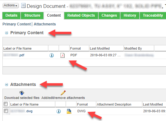

One further point on the first question.
If it's digital, you can add it as an attachment to the Content tab of a WTDocument, or if enabled a WTPart.
Many companies don't use the WGM for AutoCAD but use the WTDocuments.  You put the PDF created from the source file in as Primary content and the AutoCAD drawing (or other source material) as an attachment.
The process of showing the PDF as primary content and the source files (being other digital objects) attached as content is used by many companies I've seen.  I've shown it here on a WTDocument where I think this process works best, but if it is enabled content can be added to WTParts as well.

@JHall I may have to look closer at your suggestion for about using WTDocuments for AutoCAD files. This seems like it could be more obvious for users and solve some of our headaches. It also doesn't require having additional Workgroup Manager licensing. Thanks!!
