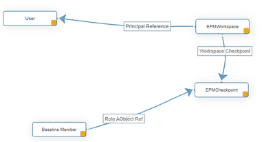

I created this Query Builder report with this Table joins:
I modified it to include a count of workspace members but it has the effect of not displaying empty workspaces. I tried fiddling with the outer joins but it still shows only ones with content. Perhaps its the constraint. To match what you see on screen, you have to filter out baseline members that are EPMSepFamilyTable objects. See zip of QML below.

You should see a zip for download of a QML file which you can import to your server. That should add the report. It will not give you storage size as I assumed you wanted object count. Not sure how storage size would help you any. On the server size, the workspaces are just like baselines of objects. Locally, yes, workspaces do have local copies of downloaded and modified sizes. Are you having space issues locally with user's workspaces? Here is information how you can managed that:
https://www.ptc.com/en/support/article/CS37763?source=search
But the local cache size is combined for all workspaces since that is how its managed. All files exist in a single folder whether downloaded (sid) or modified (lid). If you still need to get an estimate of filesize, you would need to add in joins to the baselinemember to EPMDocument then to Application Data which is where you can total up filesize for the objects in the workspace. Still confused how this report would be of any use.
