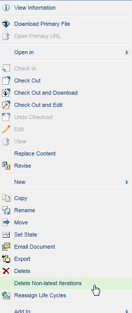

"Delete Non-latest Iterations" is on my Windchill 11. The screenshot below is from doing a right click on a searched document. Does the user have Delete privileges? Are there iterations of the object in question?
I just saw that we have this message with right click "Delete Non-latest Iterations" with certain fil types (.dwg .tiff) we don't use article in windchill...
but with creo elements (creo 3D and drawing) this function isn't available...
