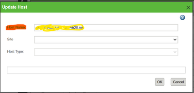

1. the vault is configured on the same server where application is installed. so the path you have mentioned in the 2nd scenario will be applicable right?  and also the vault folder should be copied from prod to dev server ?
2. what are the efficient ways to copy the vault drive (80GBs) from production to development windchill servers (both are hosted on different VMs). Eg. below both the drives are for vaulting for production.

1. Yes.
Per your images, it appears the system is using the default upload vault and it resides inside the Windchill load point.  The master vault has a read-only root folder mount on the E drive and a read-write root folder mount on the F drive?  The clearer picture would be the mount paths from Site > Utilities > Vault Configuration > Site > Master > Root Folders.
Provided drive letters and paths are not changing, you can just change the host names and not worry about path mappings.
### Vault Host Settings ###
source.fv.hostname.0={(as DB user) select hostname from FvHost where hostname not in ('masterDefault');}
target.fv.hostname.0={match syntax of source (server name or FQDN)}
Observations...
A. You can also skip file vault rehosting in the rehosting script and just do it by hand through the the Site > Utilities > Vault Configuration page.  If you are doing it just once, do it by hand (3 minutes effort).  If you are planning to rehost the dev system regularly, invest the time to use the rehosting script.  Really, in your situation, assuming all the drives and paths don't change, all you are doing is renaming the master site's host. In Dev, after finishing the rehosting script, select Site > Utilities > Vault Configuration > Sites > Master > Hosts > double click on FQDN and rename it to the Dev server's name.
B. Always remove unreferenced files from production before cloning the database and file vaults to reduce the amount of content to copy.  The database and file vaults must be in sync for a clean rehosting.
C. Using the default upload vault is a good practice.  Leaving the default upload vault mapped to the OOTB default location is not recommended.  PTC's perspective is they "own" the Windchill load point and it is their prerogative to change it at any time through software updates and upgrades.  They have never moved the OOTB file vaults location and likely won't.  But we should adhere to their perspective and place the file vaults somewhere outside of the Windchill_12.0 folder like D:\PTC\Vaults.  Using the OOTB file vaults mappings also impacts temporary backup restore point copies of the Windchill load point.  The current configuration unnecessarily includes however much content is in the default upload vault.
D. For an identical clone (what you are doing), all the file vaults need to be cloned to the Dev environment.  Otherwise, Windchill will throw errors when a developer tries to retrieve data.
E. If disk space is an issue, the rehosting script can perform a partial vaults content rehosting, but it is terribly tedious to setup.  I've used it before and relocated all my Development file vaults to D:\PTC\Vaults, eliminating additional vault partitions: E and F.  Windchill needs the full folder structure for each root folder.  The content files are only necessary when attempting to open content objects.  The greatest challenge is copying administrative content objects like templates and other site/org level content.  The entire process is just messy.

Yes, the master vault has a read-write root folder mount on the F drive.
we do the full rehosting once in a 6 months. so we can do the full vault part manually as you suggested.
we requested our Infra team to copy the Vault drive E (Read only) and F Drive (Read & Write) from production to Dev server. this will make sure the paths will be identical. so we can use this step as you have mentioned  "select Site > Utilities > Vault Configuration > Sites > Master > Hosts > double click on FQDN and rename it to the Dev server's name."? that's it?
is there anything else we need to take care of so that we don't face any error while opening any CAD/files.?
