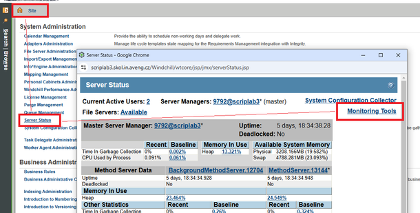

Hi @Sandy7
It is bad. 😄 but you can use the log viewer from Windchill GUI
1. Go to the Site
2. Open a Server Status
3. Open Monitoring Tools
4. Open Log File Viewer
5. Select wt.log dir check box
6. Search the log files (the file name pattern is case sensitive)
hope this can help.

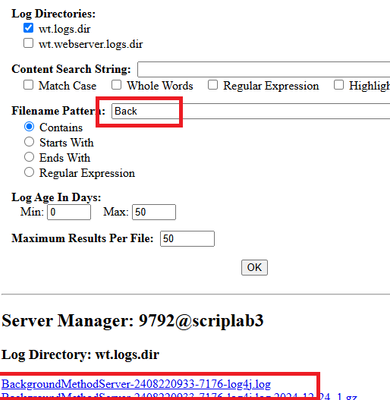

HelesicPetr
(To:Sandy7)
Hello @Sandy7
The workflow is usually run in a Background method server and all events are run from queues.
So any error from the workflow is logged in a Background_MethodServer.log file
Check what time the workflow has been stuck and use this time for searching in the log file.
Go to the logs folder on the Windchill server <WINDCHILL_HOME>\logs
open the BG log and search for the time.
be sure you open the bg log file from a day when the issue apeared
One file is created every day for logging.
Based on the error in the BG log you can get the idea of the root case.
share the error stack error.

Sandy7
(To:HelesicPetr)
Hi @HelesicPetr
thank you for your reply.
where can i check the BGMS logs from? i don't have access to server folders
Br,
sandeep

Sandy7
(To:HelesicPetr)
that is really helpfull.
do we have any article where i can learn about this utility more?
Thanks again for help..!
