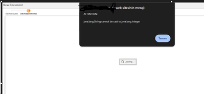

Hello, when loading New Document, it gives the error shown in the picture.

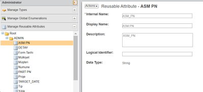

I changed the attribute of the document. I made All Attribute data types string. I keep getting the same error. Would you support?

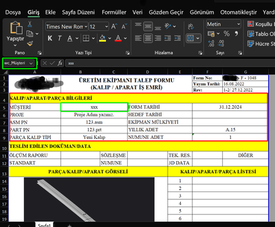

The template is in excel format. All attributes have been inserted..
Best Regards
Selim AKCELIK
Hello Selim,
This might be happening due to post-upgrade issues.
try reload the doc preferences on windchill shell by using the command below:
windchill wt.load.LoadFromFile -d <windchill_path>\Windchill\loadFiles\preference.documents.xml

Hi @selim_akcelik
What about your source input xls file?
What type are the columns ?

But I would try to use String

In Excel, something that looks like an integer can be stored in String (text) format or it can be stored in the default integer format.
I think that Windchill needs to receive integer format in this situation. Just a guess.

As Petr says, text is the same as string.  Your Windchill import is probably expecting string, and your Excel integers probably need to be in a string format before import to Windchill.

selim_akcelik
(To:egun)
Hİ @egun
Thank you for the successful solution.
