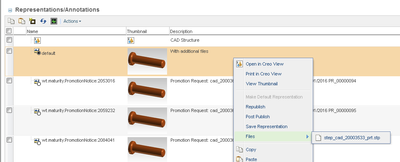

I recently switched from Windchill Essentials to PDMLink.
In Windchill Essentials the worker created several export formats according to the EPM-doc-type (pdf for drawings, step for cad-parts, etc.).
Though I did not changed "Creo View Configuration for Site"
(under Site->Utilities->Visualization Configuration Administration ), additional files under "representations" are no longer created.

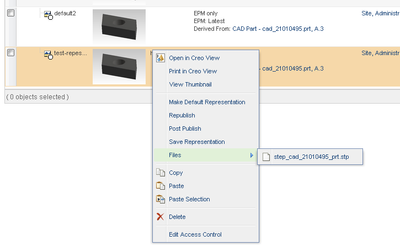

e.g.
a cad-part, which was released and published under Windchill Essentials, shows an available step-download

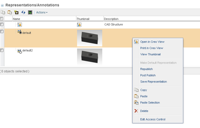

a cad-part, which was released under PDMLink, shows no step-file

indeed "xconfmanager -d publish.usesPublishRules" gives back
Property information for 'publish.usesPublishRules':
   Multivalued property delimiter:
   Values:
   - ARBORTEXT
So, the "PROE" part is missing.
I changed the config and will give it a try.
Update:
it works!
