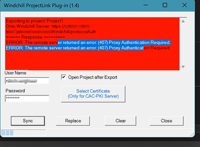

I am using Windchill ProjectLink Release N/A and Datecode with CPS N/A
we just installed project link and the save button shows up in addin menu for ms project 2016. we clicked on the button then a login window was raised but it did not ask for the sso login see attached window. then we got a proxy error when clicked synch why does it not asked for sso what url need to be whitelisted
Here are the errors that I faced
proxy 407 and missing sso login prompt

There is no screenshot attached

I have attached the screen shots
I found this article indicated a known SPR that SSO does not work with it:
https://www.ptc.com/en/support/article/CS393174?source=search
Does this match your version? I would inquire with PTC the current status of the SPR or perhaps insiders can chime in.
definitely read like it is related

here are the scree captures.  this issue is with windchill +
Since this is Windchill+, I would open a call with PTC.
