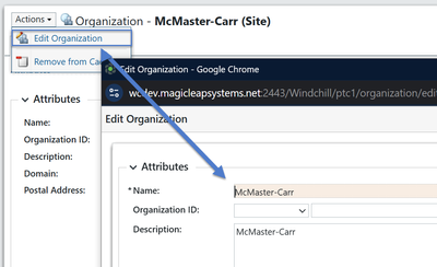

There's an easier way to do this. You can go to Participants administrator and search for the partner's org. From there, you can edit the partner's name and details. This will immediately apply to all parts from that partner!
AA_11007139
(To:joe_morton)
could you please organize meeting to check together the issue
address mail : adel.akrout@leoni.com
I'm sorry I am unable to meet with you. But here are some more specifics to help:
  • We are using the SUMA module (I think you are too). As an example, we have the Supplier McMaster-Carr in Windchill.
  • Here in the Participants Administrator, I searched for McMaster-Carr and I found the Site that got created when the Supplier was created
  • Click on the Site to open it's info. From there, you can click Actions -> Edit Organization
  • The Site's name is editable here. Changing this updates the Supplier name as well.
  • All the parts associated with that Supplier will show the updated name

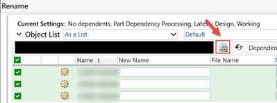

Try using "Rename" and change the Organization. This can be done on multiple items at once:
