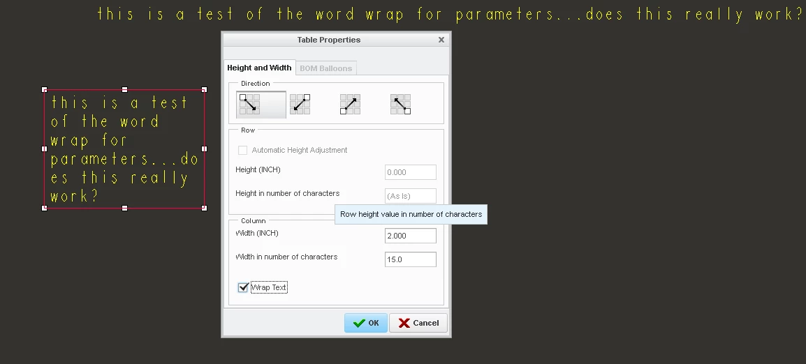

StephenW
January 6, 2014
So after how many years (I know we asked PTC about it in 1996). Wow, they listened, I'm impressed. I had to test it because I didn't believe it. Not that I didn't believe David, I just didn't believe it.
[cid:image001.png@01CF0AE1.BD1A71E0]
January 6, 2014
So the advantage to the huge relation we used to use is it only wraps on a space. The example you show below wraps right in the middle of the word "does".

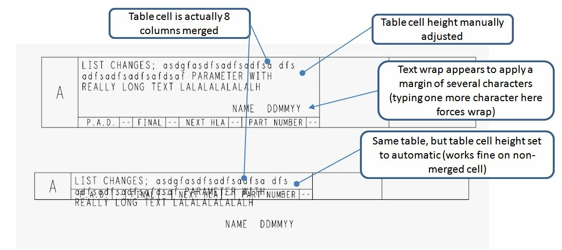

January 7, 2014
I was just testing this functionality as we prepare to move from Wildfire 4 to Creo 2 M090. It works pretty well (finally). But it looks like it leaves a margin to the right of several characters. Does anyone know of a setting for this?
The other add to tables with this transition was auto height adjustment, but I'm finding it does not work if the table cell you're working with is actually several merged cells. Can anyone else confirm this? I was hoping the auto-height would be a nice setting for our revision table.
see attached picture
