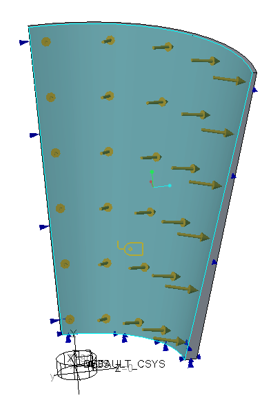

Why is it that displacement for a cone is not rotational symmetric for an internal pressure?

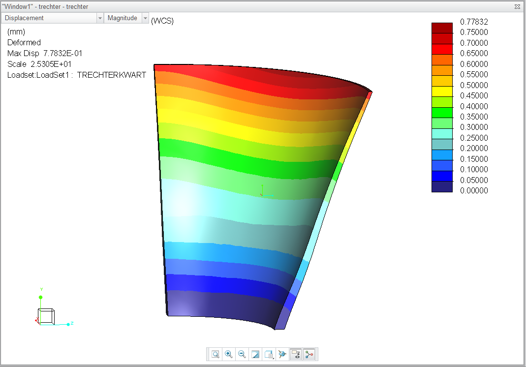

A sample model is attached (Creo 3.0) I've brought it back to the bare minimum. 1/4 cone, symmetry, default mesh etc.
It doesn't help if you refine to enormous amounts of elements, Large deformationm analysis makes it slightly better, but it is never right?
Why is that? it should not happen.
How do we solve this?
Extra: I've added a full 360 degree version in Creo2.0 format

I'm not able to open your model as I'm on Creo2, but when creating a similar model i find:
* when constraining the symmetry planes with theta=0 the results look strange
* when constraining the symmetry planes with a carthesian csys the results look okay
Not sure if that is the case in your model, but worth a try?

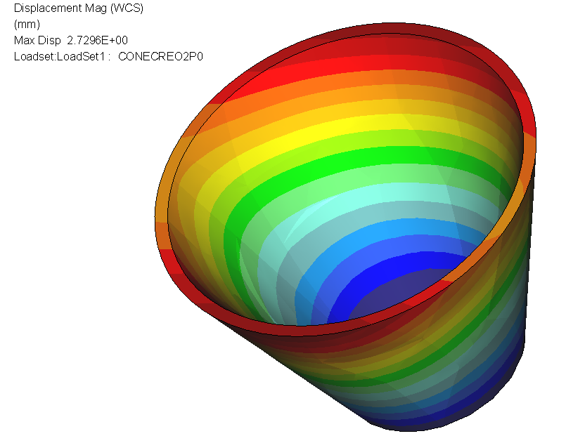

Thanks for your efforts. There is also a Creo 2.0 model in the attachments. That one is 360 degrees, no use of symmetry BC's, severe non-symmetry in the results though. (see the 360 deg picture). we're studying out-of-roundness for a valve, so this result is thoroughly unacceptable (and totally unexpected). Would appreciate your solution

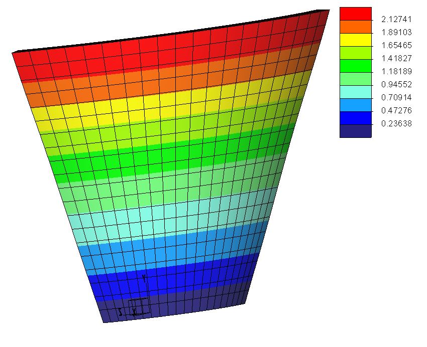

February 23, 2015

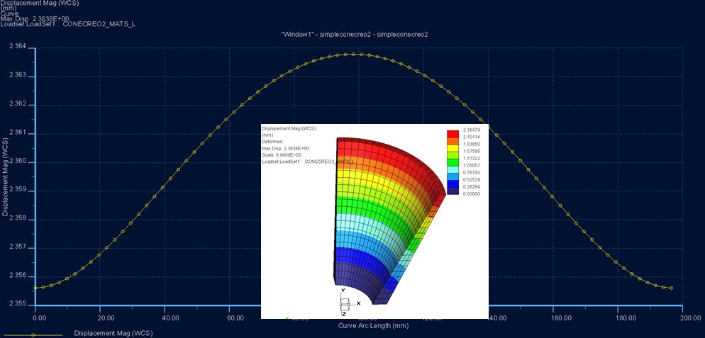

I get symmetric results. I tried both planar constraints on symmetry surfaces, aswell as constraining "theta"-direction in a cylindrical csys. Default mesh + SPA gives a small deviaiton from perfectly symmetric results, mapped mesh (as in the picture) gives perfectly symmetric results.
/Mats L/
See attached model (Creo2)

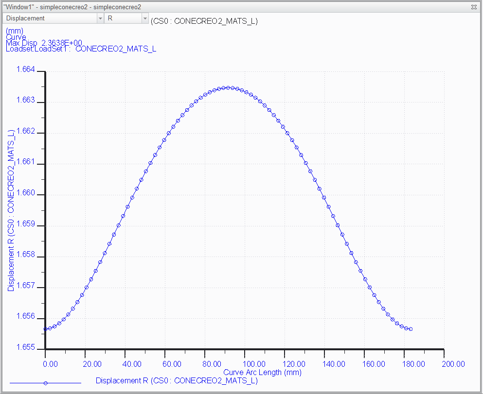

your model looks like it shows much better results, however: If I plot radial displacements of the top-edge, I get the following
It's only .5% unroundnes. But should be zero.

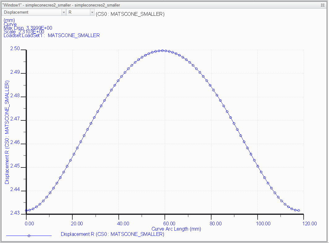

if I alter the diameter of your cone from 200 to half that, the calculated unroundness increases to 2.8%
I've attached your model again, with added cylindrical coordinate system and in the smaller diameter.

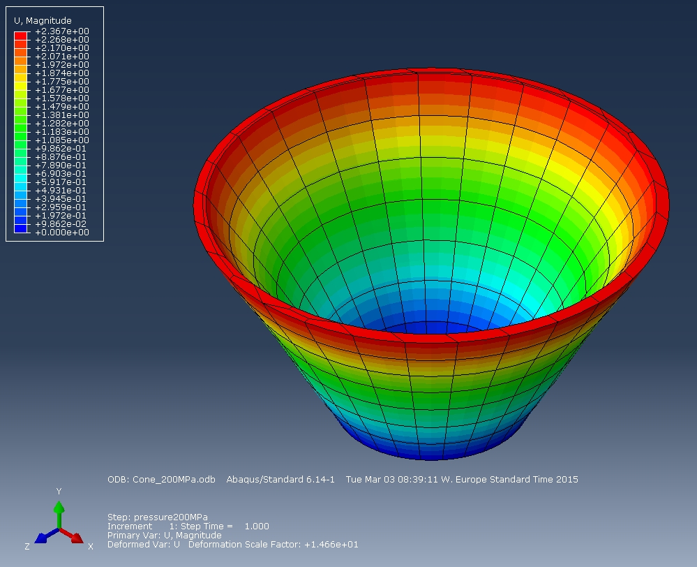

March 3, 2015
In Abaqus it was perfectly symmetrical, already tried it (and threw away the results after checking).
ehaenen1-VisitorAuthor

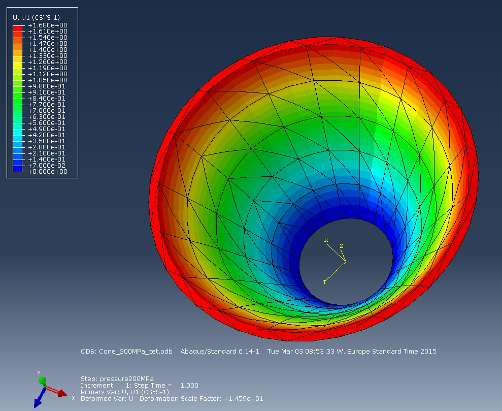

March 3, 2015
Tried it in Abaqus too. Made pictures before I threw away the result.
Made very coarse meshes in both hexa's and tets.
Differences in radial displacement around the circumference were less than 1% for both versions.
Erik

March 4, 2015
Agnes, here is a file I created for Creo2. Mapped mesh with small deviation in displacement. Still, there is a small deviation where there shouldn't be any. The displacement is smaller where the planar constraints are located. Do the constraints add stiffness somehow?
/Mats L/
