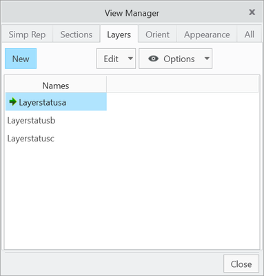

Not sure if this meets your needs, but have you tried this? In View Manager, you can save different Layer states and then switch between them:
Thanks. But this I could not control the layers using pro/program
