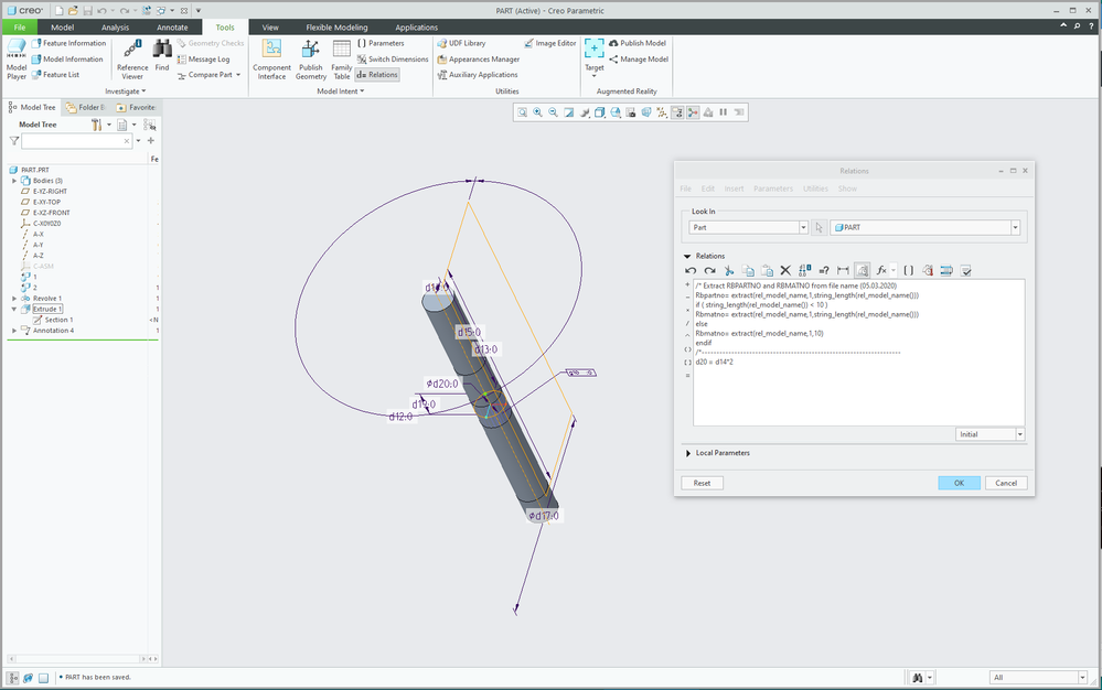

I added new surface feature Extrude 1. This feature has no relation to 1 and 2.
Diameter of Extrude 1 is driven by relation d20 = d14*2d14 belongs to Revolve 1.
Geometric tolerance is attached to Extrude 1 surface.
I can suppress 1 or 2 ... geometric tolerance is not affected by suppressing action.

The solution you suggested I tried. But I feel this will work well for simple parts. I am working with parts of complex geometry and this dummy surface creation makes difficulty in defining and reading over the existing solid features.
Could you suggest some other method?
