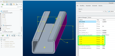

I am studying the AFX module "Creo Advanced Framework Extension" and I notice something as strange as it is interesting that I cannot explain. In the model of the library "\parts\profiles\steel_beams_mm\c_beam.prt" there are parameters associated with dimensions, see B_STR, H_STR, T_STR, C_STR, they have zero suppression and are approximated to two decimal places.
The question is: I would have expected to find relationships that would define its values ​​and instead, there are none! So how is this possible? Where have they been defined?
I tried to see if they were defined inside Pro\Program, but nothing ...
To achieve my goal, for similar shapes, for now I have duplicated this model and reused these dimensions, but I would really like to understand how this thing is possible to apply it to new shapes.

Hi @bmancini ,
there is a logic in AFX that creates those parameters. The "magic" is created by the parameter BUW_DOUBLE_TO_STR_INFO followed by the named dimensions and the required decimal places.
