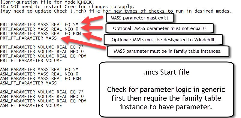

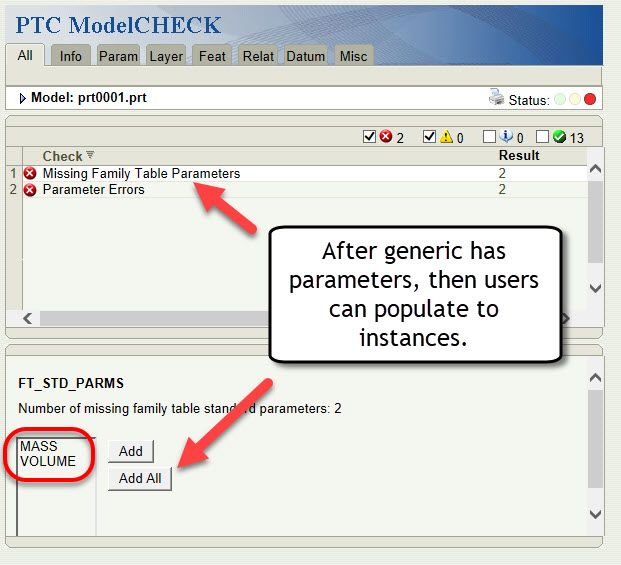

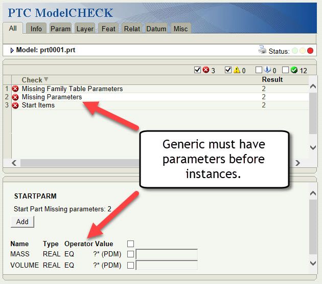

You can require parameters on the generic first using PARAMCHECK and then you can require that those parameters are in the family table using the FT_STD_PARMS check in the start (.mch) file. For MASS and VOLUME parameters, you may want to drive this from a relation (which could be another check). See images below.

This is still possible if there is a custom parameter added as a relation equating to the system parameter. Like:
CUSTOM_PARAMETER=pro_mp_mass. I was able to add the weight column using ModelCHECK. But after adding the column you need to manually regenerate the assembly and verify all instances so the values are populated.
