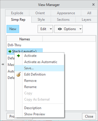

I am able to add a component to one of my representations in the assembly and save without an issue. When I go back into Creo for a new session, the added components are still in my model tree, but they are not visible within the assembly. I can manually change the representation to master within the model tree to show my part, but it will not save for the next session. I would like to keep this component visible whenever I open this representation.

You have to save the rep to make it "stick"
Set the part to show in the rep you want it to show, open the view manager (the rep should show a (+) by the name to show it's modified.
RMB on the view and click save. (or Edit - Save in the view manager window).
