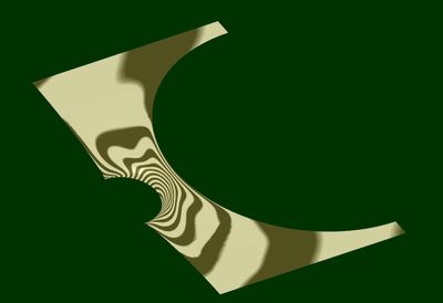

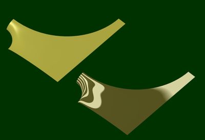

I have attached a render picture of what I am trying to create (made by a friend in Rhino), pictures of my sketches I have made, and pictures of my best result with and without surface analysis.
What I am trying to do is to make a surface between the different sketches but no matter what I do, it is either failing, or the surface quality is bad using analysis.
I have used several techniques, and I have also tried to use the Style feature.
What I Hope is that you can help to me learn how to do this geometry with a good quality surface. I know I am missing some features, steps or adjustments in order to do this right, but at the moment I have hit a wall with my experience.

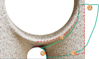

While there are tools for N-sided patches, generally it is better to create 4 sided surfaces. Overbuild a 4 sided surface and then trim it back. I would follow the green boundaries shown below. Pay attention to the construction curves used to define the bounds and their connections such that they support G2 (curvature) or higher order connections where needed. You may need to use composite curves to get a boundary suitable for the goal (#2 in pic below).
To access the n-sided patch you need to set a config option see this article (I am not suggesting this is the best approach to your issue):
https://support.ptc.com/help/creo/creo_pma/r12/usascii//index.html#page/surfacing/surface/To_Create_a_Surface_from_More_Than_Four_Boundaries.html
As an alternative approach, based on the rendered image I see a possibility to use two surfaces of revolution about the holes and an extruded surface in the vertical direction that would intersect the revolved surfaces to generate the core geometry which you would then "patch" with an overbuilt 4 sided surface(s).

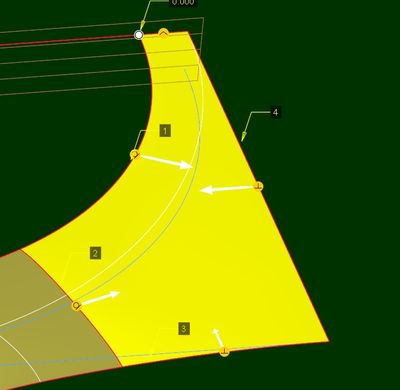

Hi, attached is what I've got from the curves I approximated from your pictures. Is this close to what you wanted to achieve?
BHOoi
(To:BHOoi)
mirrored
DH_14427784
3-Newcomer
(To:BHOoi)
Hi BH0oi, 🙂
That looks exactly like want I am trying to achieve.
Do you have the recipe for that? 🙂

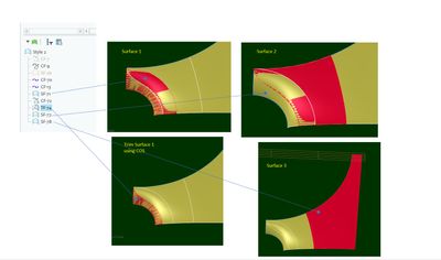

Hi, DH. These are the steps I used to create that final surface:
I attached the 3D in my last reply and you should see those curves I used to in my steps.  Hope this helps

Will you be able to export your file with the features in the feature tree?
The file you've sent was only for looking.
Also, the last surface (SF-78) is a 5-sided surface blend. How is that possible?
Kind regards 🙂
I am unable to send you non-creo format with model tree. I am not allowed to send out the native file from my computer. Do let me know if you need other formats.  The picture in my last reply does show all the entities in the style features. yes, SF-78 is 5-side surface and it can be created quite easily. Feel free to reach out to me for any further questions.
