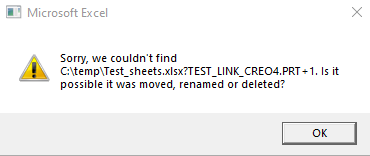

I can add the link without issue. When I try to access the url (excel) sheet, I get two warning messages saying that Excel cannot find the file, then it opens it in read only mode.

I read those articles as well. However, there are eluding to the path of the file being too long. As you can see from the error image, my file is located in C:\temp. Therefore, that can not be the issue. This still doesn't explain why the excel file eventually opens up in "read only" mode.
