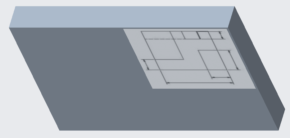

I have run into this issue before and haven't been able to find the setting to fix the issue.
I have a workstation with a RTX2080TI NVIDIA graphics card running Creo 4.
The surface in the attached image should show a single line drawing in the view in the upper right corner of the image.
Anyone know how to fix this and what the config.pro settings should be?
Thank you!

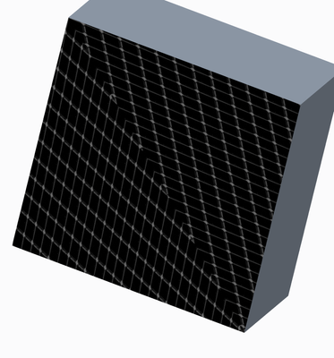

When I apply the image It repeats the image multiple times across the surface.
Is there a way to prevent this from happening?
This is what it looks like
This is what it should look like below

I guess it is graphic card driver problem.
If I were you I would try setting following config.pro option temporarily
graphics  win32_gdi
If this setting resolve the problem, then you have to experiment a little ... download and install several graphic card driver version and test their functionality. Of course, you can open case at PTC Support !
... and you cal also test following config.pro options (see https://support.ptc.com/appserver/cs/view/solution.jsp?source=subscription&n=CS169272 )
enable_opengl_fbo no
enable_opengl_vbo no
enable_opengl_shader no
Martin Hanák

to display image properly I had to place it onto datum plane offset by 0.01 mm from model surface.
Martin Hanák

Hi Martin,
Thank you very much for your help!!!!!!
The following 3 options have me back up and running again
Thank you!!!!
