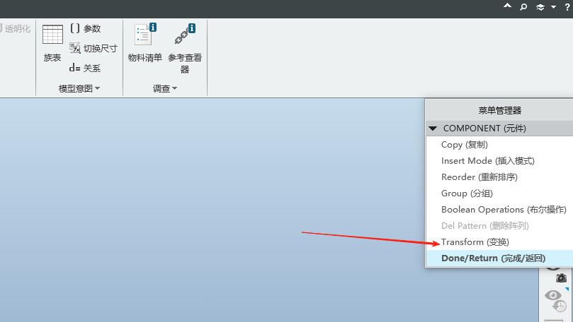

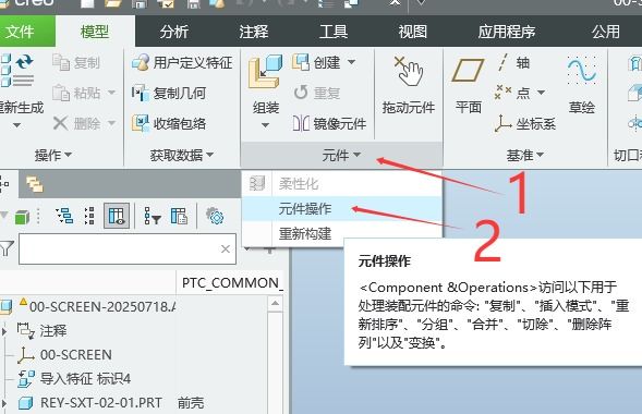

I was able to use the Transform feature under Component Operations for one component of my assembly. Now I want to use Transform again on the same assembly but I can no longer find it in the Component Operations' menu

Thanks, that is what I was expecting to see indeed, but I can no longer see the feature in the menu

To give an update on this, I opened a case with PTC who suggested to verify the following steps. I tried them all, but still I cannot understand the logic behind the appearance or not of the Transform option in the Component Operations menu, sometimes it is available and then not anymore 🤔
  • Ensure a Coordinate System (Csys) is selected before accessing Component Operations. The Transform option only appears when a valid Csys is active.
  • Confirm that the component is not the first placed in the assembly, as Creo restricts transformation for the first component.
  • If constraints are limiting movement, try editing or suppressing them temporarily via Edit Definition.
