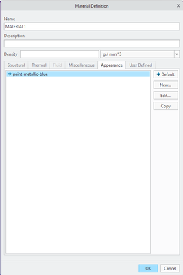

Is it possible to define a color from appearance.dmt to a specific material in the .mtl file itself?
I want all parts made from SAE J995 Grade 5 to be a certain color. Is there an entry that can be put in the material file to change the color when the material is assigned?
kdirth
(To:BenLoosli)
When defining (or redefining) the material, go to the appearance tab, select new, pick a color, and set the color as default.  Back in the Materials window select your material and save.

Yes it is. See the article below:
https://www.ptc.com/en/support/article/CS50533
Chris3
(To:Chris3)
I linked to the wrong thing. Try this instead:
https://support.ptc.com/help/creo/creo_pma/r9.0/usascii/index.html#page/model-based_definition/to_edit_an_appearance_of_a_material.html
In short you need this in your mtl file:
Name = PTC_DEFAULT_APPEARANCE
Type = String
Default = 'glass'
Access = Full
and you need a corresponding appearance in your global.dmt file
kdirth
(To:BenLoosli)
it seems to me that the appearance mentioned in material definition file must be included in global.dmt file.
Please read https://www.ptc.com/en/support/article/cs227662 article.
