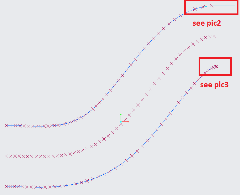

Hi guys,
I'm asking for your help on a new problem I've encountered in my design.  I want the flow path thickness at the 50 points along the meanline to be locally perpendicular to the meanline. For acheiving this I used:
x_h = x_m + (h/2) sin(theta)
y_h = y_m - (h/2) cos(theta)
                                                              m: meanline ,  h: inner casing,   c: outer casing
x_c = x_m - (h/2) sin(theta)
y_c = y_m + (h/2) cos(theta)
where h is the local flow path thickness and theta is tan^-1(deltay_m/deltax_m).  I've created a spreadsheet to do the calculations. Everything works fine, except for last 4 points along the inner casing. I want the inner and outer casing curves to be tangent to a vertical line at the end points, however I'm having troubles achieving this.
I've included a spreadsheet and a .prt file. Also, I used backward differentiation for calculating the local theta at the 50 points along the meanline.
thanks

MartinHanak
(To:edi)

Hey Martin,
The last points of the meanline, inner and outer casing should lie on a vertical line. For the outer casing, based on the spreadsheet the x- coordinate of the last point is slightly off from the x-coordinate of the meanline, so I can extend the it with a horizontal line to make the spline tanget to the horizontal line. However, If you look at the spreadsheet for the inner casing as we get close to the end points the x and y coordinates of the inner casing start to become less than the corresponding values of meanline, which leads to that distortion that you see. I can delete the last points which their x-coordinates beggins to surpass the x-coordinate of the meanline, and draw a straight line, but I don't think this is good idea since its compromises having a smooth transition.
