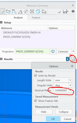

This is the better way to do it. Using the transform matrix causes rounding issues and for angles that have a long throw distance those small rounding issues can have a measurable error.
Yes, when using transformation matrix always set to best accuracy.

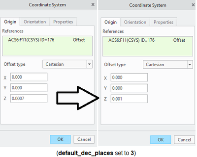

pausob
(To:tbraxton)
AFAIK, it has always been a hidden feature in the GUI - this "magic" of re-defining the 6 parameters for placement and orientation for a (placed) CSYS by selecting the reference coordinate system after.
Keep in mind that the precision of the 6 offsets is related to the current setting for default_dec_places and there might be an unexpected rounding-off error.
For illustration, I work in mm and so typically, I have the setting default_dec_places equal to 3.  So if I try to specify displacement of, for example, 0.0007, system will round it out to 0.001:
