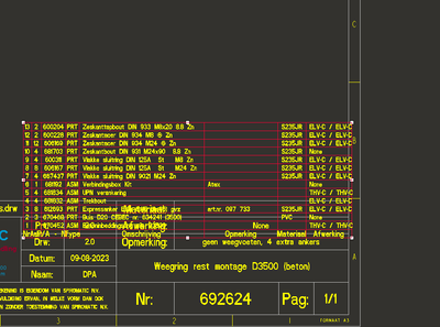

BOM table size became incorrect after changing the size from A2 to A3.
dirk_paelinck
6-Contributor
Creo version : 6.0.5.1
Now I need to delete the table and all BOM balloons has to be created again.

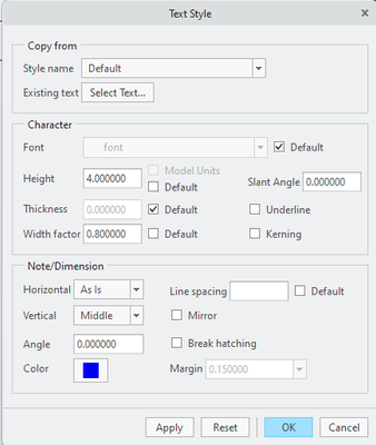

You can reformate the BOM to the size you need (text size, column width, etc).
Select table, RMB, select Text Style, and change height.

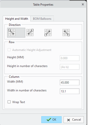

Select a column, RMB, select Properties and change width.

Please explain why BOM table size became incorrect. It seems to me that it is just placed in the wrong place. You can move it to the right place.
2.]
Often BOM table is included in format file (.fmt extension). When you replace A2 format with A3 format you have to decide whether you want to delete tables which belong to A2 format. If you do not do this, then you will have duplicate tables on the drawing and some of them will have to be deleted. If you do this, you will need to recreate BOM balloons.
