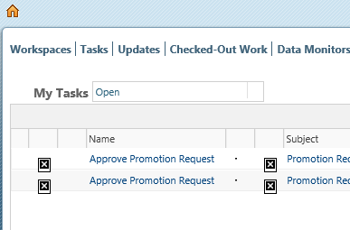

bsod is now resolved, but somehow the icons within windchill are not loaded anymore:
MartinHanak
(To:Mat)
Please show the problem to PTC Support.
Martin Hanák
Mat
(To:Mat)
had to delete internet explorer's cache.
Everything is fine now.
