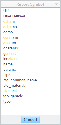

These are the options under asm.mbr. when defining the content of the cell. I don't see any options with your syntax in this list.

Sorry for that, I miss read the parameter. That is the same pick we are using.
Like I said if you are using that to pass values into windchill, then you can't use many of the features in the repeat region editor, like recursive, filter, etc. Your assembly has to be flat. If you have sub-assemblies that you would like to show the contents of in the BOM, but not the sub-assy itself, then you can't use sub-assy's to do that. You need to make a UDF of the sub-assy and assemble that. That keeps the assembly flat so that the BOM works.
