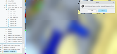

Hi everybody
Do you know how I can delete an assembly in an assembly?
Br,
Hasan

The way your question is phrased, Just select the assembly and push delete.
I'm guessing there is more to it than specifically how you asked the question?

I am trying to delete this ammaebly, but it does not work.

You want to delete the group? And all the components in the group?
Or  you just want to remove the group?
Use "ungroup"

Can I delete a group directly?

I'm still confused.
Do you want to delete the group AND all the components (or features or whatever)?
Then just use RMB delete and hit OKAY.
If the components or features within the group have other references, you will get a different message asking how you want to handle the references.
HM_10752623
(To:StephenW)
Thank you so much for the help. It is solved now. I would delete all the components in the group. i ungrupped them, and then deleted. It worked. 🙏👍

To @StephenW 's point, a group is not an assembly, it is just a method to clean up the tree and organize parts.
