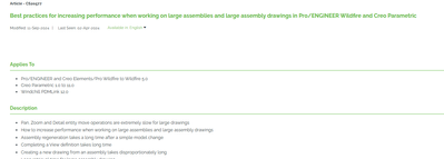

@e_santoul
Check if article CS20577 can help..

Shred article CS20577
Hi, that article page has not-found error message, does it happen to you too?
StephenW
(To:tleati)
Seems to work fine for me. To see the entire article, you will need a ptc support login  with appropriate access.
But even without that you should be able to see some of the article.
