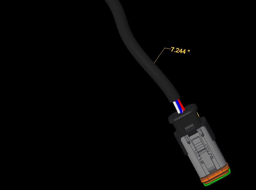

I have routed a cable.  How can I display the length of the cable in a table (i.e. what parameter captures the length of the cable)?  Thank you.

-1,-1 is the correct format

I recall using a repeat region in the past that brought in the length values,  but I can't remember if it was for a cable or a pipe.  Does that ring a bell to anyone?  I would think the repeat region would be calling for the same parameter.
Worked sweet.  Everything created while in cabling mode (annotation and relation)!
