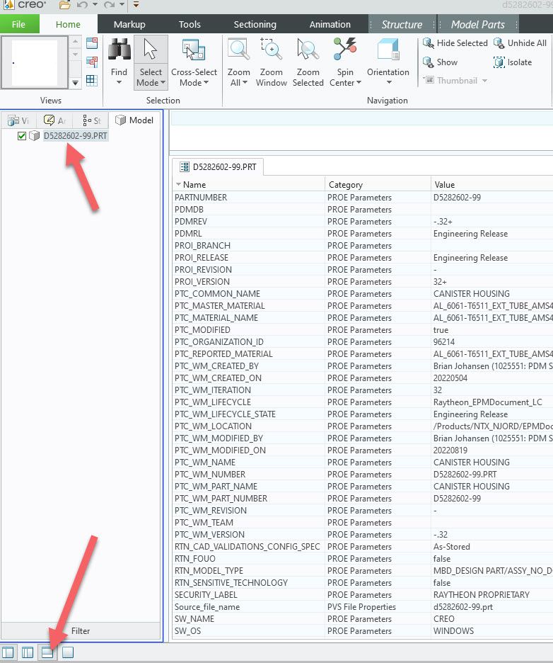

In Creo View, select the model and then Toggle Lower Data Panel to see all the models attributes, Creo and Windchill.
August 9, 2023
So...  we are not using Windchill (I know.. I know...)  we are using Teamcenter.   So i would like to know how to get the info from that FILE HISTORY function from within Creo.  It seems it doesn't export that information.  Just all the other parameters.
