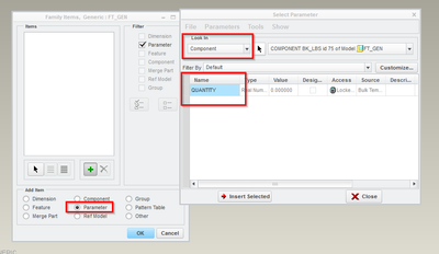

You don't need the table relations at all, that is complicating it.
Here is my process:

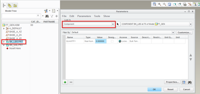

Create a Component Paramter (Parameters, Look in "Component", and select the component) call Quantity.
Repeat for your other bulk component, name it the same value.

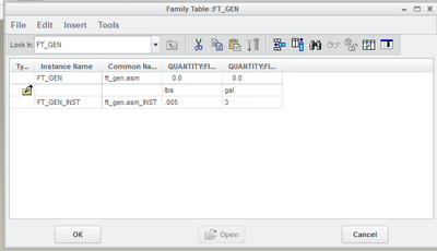

In your family table, add a column, choosing Parameter, Look in Component, and choose Quantity.
Repeat for the other Quantity component parameter, so that they both are in the family table.
In the family table, you can change the values for each instance. I added a comment row so I could help distinguish from the two values.

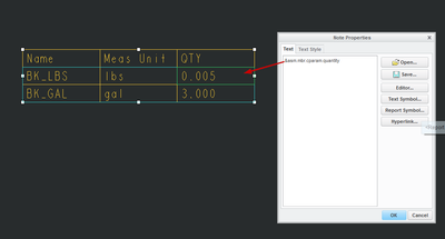

Then in your repeat region, you can double click on the top cell to define a report parameter, or you can r.click>properties and paste the report parameter there directly.
You don't end up needing any repeat region relations - by naming the Component Parameter the same thing, the table will pick up on both in the same column, even though it means different things to different components.
