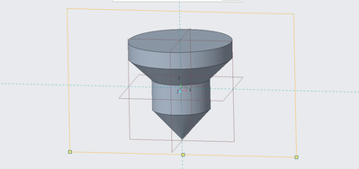

We have some parts/assemblies which have the cylindrical-like shape shown in the pictures below. We then cut the model into a quarter-section model for a reason. For the model creation, we must try two extrude and subtraction functions. We would like to automate these procedures because we have a lot of parts/assemblies. Previously we tried to use a mapkey to record the procedures and resume them, however, the record did not contain which region should be extruded and subtracted thus it does not work so well. The parts/assemblies are the almost same size so it should be fine if we subtract the same volumes from two directions. Do you guys have any idea to automate it with mapkey or anything else?
Let me hear if you have any questions.
Thank you,
The model have a shape like above.

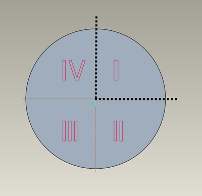

We first draw a sketch to detaimine which region should be extluded.

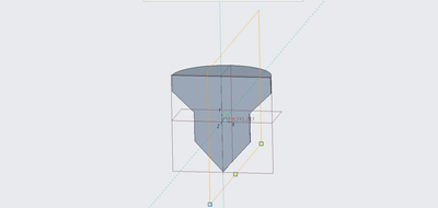

Then we subtract the volume.
For another direction, we perform same procedures.

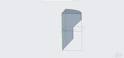

After that, we have a-quarter model.

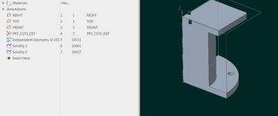

pausob
(To:Yu_707)
Since your models are similar and presumably symmetric about the standard datum planes, you might consider using two solidify operations to generate the quarter-chunk.  Just select the cutting plane, then the solidify function, then pick the side to cut-away, or accept the "default" with a middle click.
Repeat, and you're done:
If your models have the same starting structure (e.g., 3 datum planes + CSYS), you could just record this into a mapkey.
