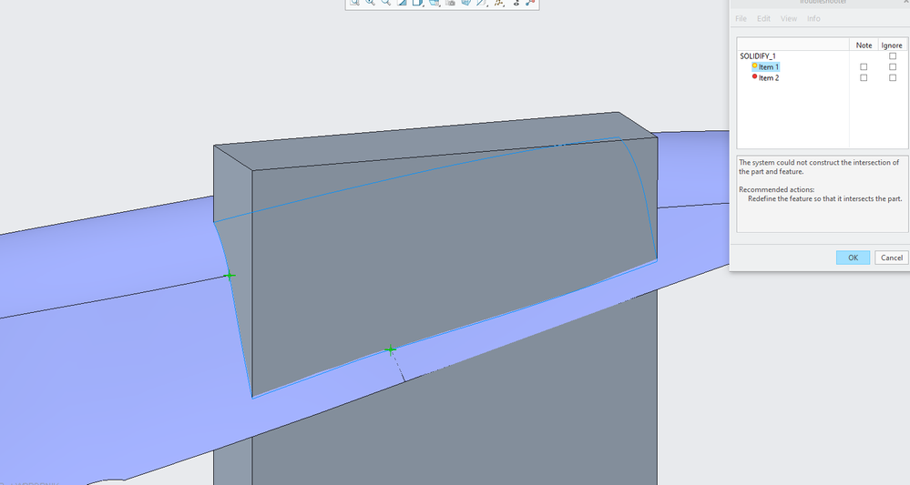

I've got a huge problem with solidify operation in Creo Parametric 7.0. In general I have the solid body (usual rectangle made by Extrude) on which there's a varius-shaped surface that was created by copying geometry from the STEP file. When I'm trying to trim protruding parts of extrude by solidifying (with remove material option enabled) I've got the following error
Please note that the green vertexes are not joined and there's a little bit place between them (the picture above has been zommed in much enough inside Creo in order to show this situation). These vertexes make my part unable to solidify which is visible in the picture. I tried to fix the STEP in Data Doctor. The Geometry Check option (in import DataDoctor tab) doesn't show any bad stuff on and in proximity of my copied surface. Therefore I've no idea why cannot perform the operation. Do you have any suggestions? Of course I'll provide more information about this problem if necessary.

Can't see well enough to tell what's going on.  BUT, you might need to tweak your Absolute Accuracy (don't use Relative Accuracy).  Also, try extending the edges of the surface to make sure they protrude out from the solid.  maybe even as little as .010 will do.

Thank you for your reply! Yes, i forgot to write that all edges protude from the solid out. Please look at the picture below
Now you can see that the surface is bigger than the solid and the egdes are actually out. You can also see the vertexes on the front and left side of the solid rectangle (in the picture I'm still inside Solidify). I tried to find some gaps inside the STEP by using Find (Tools > Find) option but even in 0.0001 scale there's no gaps. This purple surface which you can see in the picture above is a little part copied from the STEP. A I mentioned earlier - IDD wasn't show any imperfections on this part. This looks like an internal error of Solidify operation.

Something's wrong with the surface then.  I'd delete it, change the part absolute accuracy to .0001", then if I remember there is an option for importing where you can use the accuracy of the the part you're importing into, and try that.  If that doesn't work, you may have to recreate that surface internally with a boundary blend.

Post the STEP file so that it can be queried in detail inside Creo. I suspect that the purple surface is not a closed quilt but I can not tell without looking at the data set in Creo.

Well, it looks like an open quilt, but that doesn't appear to be the issue since quilts don't need to be close to use to cut solids.  It looks like either the quilt has a tiny sliver opening in it or actually collapses onto itself and that's the problem.
Thank you both for reply! The problem is the STEP geometry is hugely complicated and it's hard to see any imperfections. But what about fixing copied surface not the STEP geometry? Is there a way to repair copied surface's vertices which Solidify showing as an error instead of fixing STEP geom?

In order to "fix" the surface I would need to understand the problem with it. Try inspecting the quilt using an offset analysis in both directions, this should reveal if it is self intersecting or has a gap or a boundary that is not closed.

Check to make sure the accuracy of both parts are set to absolute and have the same value.  I have seen this type of problem many times when using the copy geom feature and the part accuracy's do not match.  If the accuracy's do not match, you may have to adjust your method of importing the STEP file.  When importing STEP files, I always set the import accuracy to external to see what the original/native file was modeled at.  If its too course, I import the STEP file using one of my start part templates and set the accuracy to internal.  We use .0001 inch absolute accuracy where I work.  If the .0001 inch import comes in with open edges between surfaces, then I go at it with IDD.
