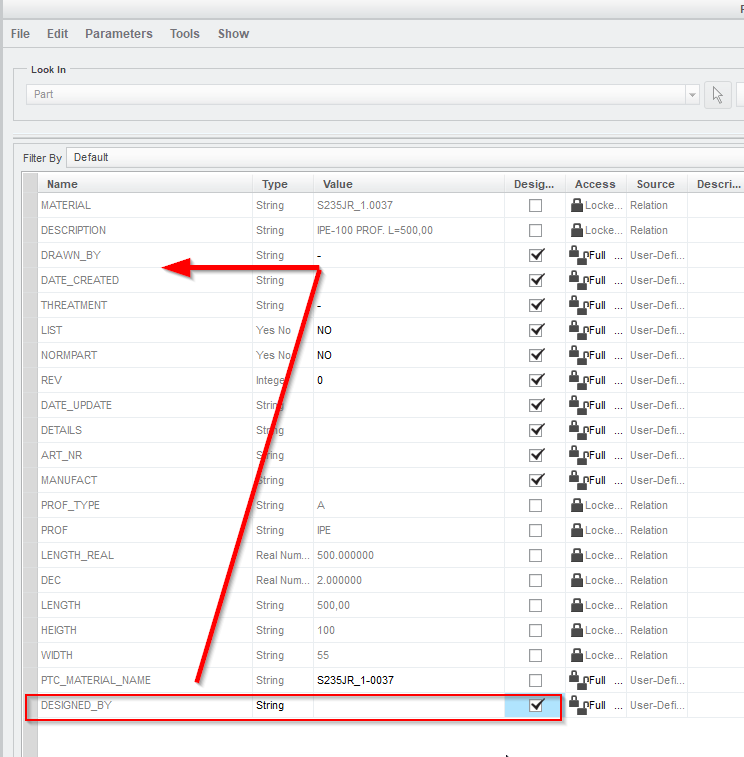

Hi guys,
I'm having some exsisting parts and assemblies in Creo3.0, these parts do have parameters. Now I'd like to create some new parameters in these parts. When I open the parameter-list, the existing parameters are sorted in the way they have been created. But now I'd like to put some parameters in between some existing parameters. Does anyone know how to do that, without deleting and recreating the existing parameters?

Hello, am i missing something here? If all you want to do is move up a newly created parameter then use the arrow keys at the right hand side. See attached image.
John

Great, I think that's the answer I was waiting for Smiley Happy
Thanks a lot. This will help me a lot!

Happy that was the answer you were looking for. I have parameters listed in a particular order too. I think i am right in saying that Creo does not always save a newly created parameter in the position you move it to. If this happens just simply move back to where you require it & it should stay put second time around.
