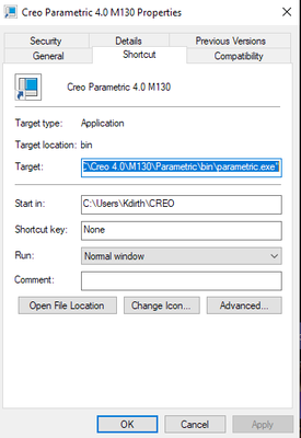

A couple of things to look at that I have seen in the past:
  • Make sure mapped drives are identical on both computers
  • Ensure Target in the program shortcut is correct and any files targeted are there especially the users config.pro file.
    • Ensure the users config.pro is not in conflict with the config.sup
If either of these are incorrect Creo will not be able to find the path to the correct files.
