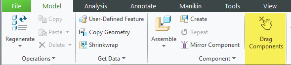

Snapshots are used to configure the kinematics of the mechanism in mechanism mode.
To control the visibility of components displayed in an assembly the simplified rep would be used. Simplified rep functionality is available in part mode and assembly mode (not mechanism mode). Based on your description you would create an assembly simplified rep for each snapshot that you want to display of a given assembly and set that rep to be active before entering mechanism mode.
Assuming you have the assembly constraints that accurately model the kinematics of your design you should be able to do all of this while in the model tab (not mechanism mode). This can be accomplished by dragging the components to put the mechanism in the desired position to create a snapshot or use previously defined snapshots saved with the model.
Create a simplified rep to control which elements of the machine design are displayed in assembly mode and then set the snapshot when in the model tab by using the drag component functionality which allows you to create snapshots in assembly mode.

Note that mechanism snapshot can be saved as exploded assembly state using this function:
So you can then use the above as part of the combined states make-up in order to display your mechanism in the various configurations.  To hide / display the components in different ways, you then have many options: using styles (hide/ wireframe / transparent), appearances, layers, and simplified reps...
