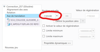

Is it possible to drive constraint with parameter ?
In my example with slider :
I want to drive actual slider position (value in red circle) with parameter
it is possible ?
thanks
pausob
(To:XDN)
Typically, you would check the "enable regeneration value" box to turn the joint into a "driver" and make the dimension available for use in relations.

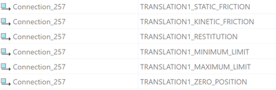

in parameter for slider, i find this
it will suffice that there is a parameter for the position, after with simply relation, mathcad can drive a slider
is it possible that there are hidden parameters that control the rest of the slider definition?

another option is to write same value in slider parameter
  • translation minimum limit
  • translation maximum limit
But is don't work

I'm not sure you can control the stroke length of a slider constraint with a parameter. I did a quick test and can't find a way to access the dimension...
One option that might work could be to use a slot constraint instead. Slot constraints are driven by a point on a line. You sketch a line and then connect your moving body by attaching a point on the body to the line. Other curve features work as well but I normally use a sketch. The length of the line drives the limits of translation and you could drive the length of your sketch with a parameter. Maybe give this a try?
XDN
(To:pausob)
after check the box, i don't have a new parameter for slider 😥

second way
the pausob's solution
check "enable regeneration value" in slider definition
and click the the slider part in 3D window, now you see the value
after it, is simply to drive the value in relation windows with mathcad parameter following the usual method
