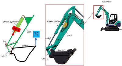

Mar 25, 2019 10:27 AM UTC
Hi TMCKEOWN,
I am going to calculate the bucket available force as showing image (Bucket cylinder force we know 700kN) without creating all linkage parts because it consume lot of time to create the parts. It means it is possible to calculate force thought skeleton sketch?
Following Force need to calculate
Max available Bucket force
Max available Link -1 force
Max available Link -2 force
