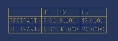

need to know how to control decimal places of family table parameters in drawing family table itself
You may want to look at this option for your table. It's mentioned in the article I sent you as well. Here is what it looks like:
You need to create a separate repeat region for each column. After that, you need to add a filter to each region so that it only displays values of the parameter in the region.
This method will allow you to use the [.#] syntax to control the number of digits in each column. You will need to turn the model_digits_in_region option off.
I've attached my table for reference.

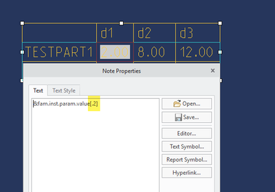

This article explains how to control the number of decimal places in drawing tables.
This video explains how to set up drawing tables for family table objects. Sounds like you've got this covered, but it's a good video.
To summarize, you need to add [.#] to the parameter name in the properties window.
  1. Select the table cell that you want to control
  2. Right click
  3. Select properties
  4. Edit the parameter as shown in the screenshot below
  5. Click OK
  6. Update tables as required

i want control decimal for each column like column d1 need to be 2 decimal, d2 need to be 3 decimal.
Ty
thanks it is working fine. but i have converted my family table from 2D repeat into simple region for this. the problem is in future if we add more columns to family table in model it wont be reflected in drawing FT.
