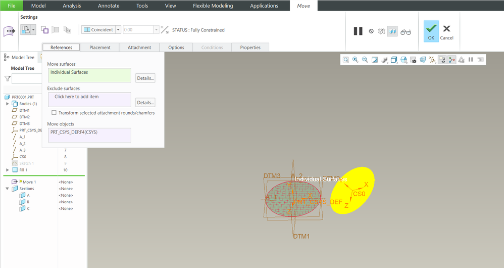

To achieve what you want to achieve (transform a copy of a quilt based on CSYS alignments), you can use FMX-Move and:
  1. select the quilt into the references collector (This is the recommended/best option. Typically you would want to do that for a body as well). That way it is selected as a “quilt-object” and not as a collection of surfaces
  2. If you do select it as a collection of surfaces, then you have to uncheck the “attachment”-option (unless the quilt is a closed quilt in which case it couldn’t attach to anything anyway).
Please have a look at this quick video illustrating the workflows:
Will check with my colleagues to get the article updated.

1) to copy a surface, users have to start the "move" tool, and then activate the "hidden" copy option.
Consider renaming the tool to make it easier for new users to discover the copy function, e.g. in MS-excel, when right-clicking on the sheet in a workbook:
2) it is bizarre that the "origin" coordinate system has to be included as an object to be moved when the intent is to only move/copy the geometry.  Again, this detail is not something that is easy to discover on your own.
3) I suppose as a consequence of (2), the flexible-move-copy procedure produces (an unwanted) situation of having two coordinate systems on top of each other --> ++clutter and confusion for future users of the model
