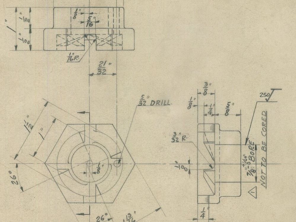

I am working on redrawing a part from an old 2D print.
I am stuck on creating the 4 internal teeth on the main ID.
I do not know how to get a 3D curve on the surface and then i can merge surfaces and solidify to make the features.
TIA
Son Nguyen
kdirth
(To:kdirth)
Here is a quick start.  I used the trajpar parameter to create the ramps.
5 REPLIES 5
kdirth
(To:SN_9271623)
Here is a simple part I created a while back with a similar feature.  Might give you some ideas.
kdirth
(To:kdirth)
SN_9271623
(To:kdirth)
Thank you so much!
