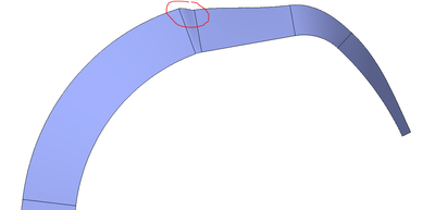

Is there an easy way to create a smooth variable draft when there are several surfaces of varying length?
Here is a simplified example of the issue:
The drafted surface is made from several segments of different length and the draft hinge is the edge of those segments.  It appears that Creo is splitting the change in draft angle evenly over each segment rather than over the length.
Is this what the draft feature is expected to do?  I was expecting it to smoothly make the variation over the full distance.

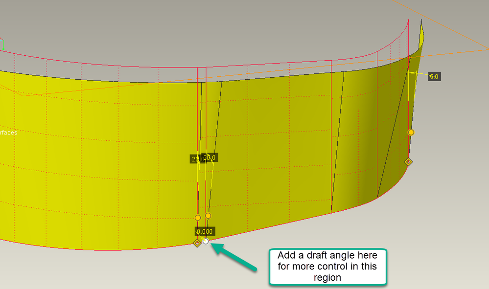

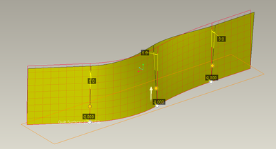

This is a quilt comprised of 4 surfaces generated from this sketch. A variable draft is applied using the sketch entities as the draft hinge. If by smooth you mean C1 continuity across the patch boundaries it is possible in some cases. Creo 7 model enclosed for reference.
Are the segments used as the draft hinge tangent to each other at the end points? I may be missing something about how you are creating the geometry, can you post the model?

All of the surfaces are tangent.  Attached is a Creo 7 example of what I am getting.  The issue is seen in the short wall segment.  Everything is still tangent, but the change in draft over that 5% of the wall appears to be about 20% of the change.
I have been able to get a better outcome by measuring the length of each wall and calculating the expected draft and adding a draft value at each intersection accordingly.

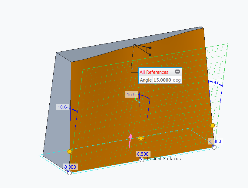

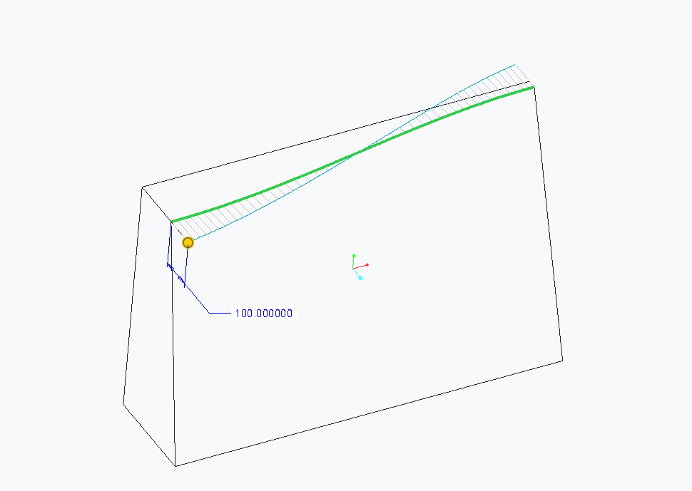

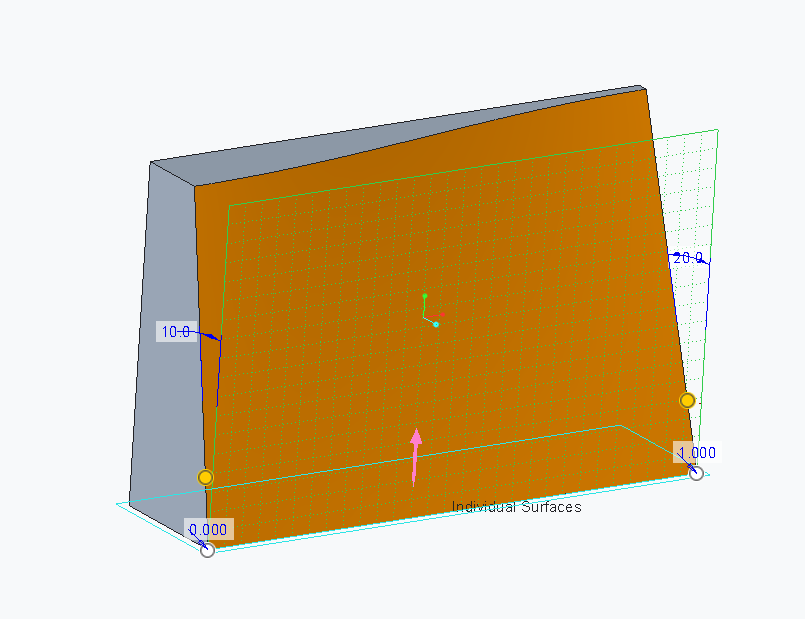

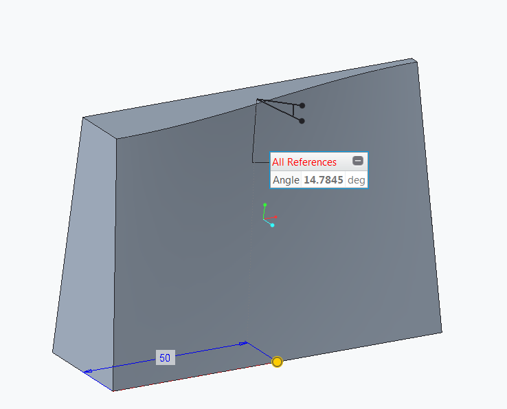

I just created a simple test case to gain some insight into how the draft angle varies between the angle definitions in the feature. It is not a simple linear interpolation. It is close but there are additional constraints on the surface that the draft is applied to that can come into play. The curvature plot can be used to make some observations on how adding angle controls affect the geometry.
The enclosed Creo 7 model has a saved analysis to measure the draft angle at any point along the drafted edge trajectory.
Simple test case model
Draft at midpoint of hinge edge
Curvature plot of drafted edge

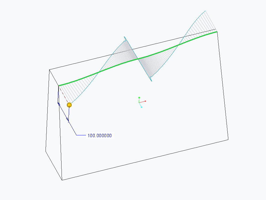

Adding a draft point to the feature on the midpoint of the hinge set to 15 degrees
Curvature plot

kdirth
(To:kdirth)
To wrap this up, because of the way Creo creates a variable draft, as shown by the analysis in the response from @tbraxton, a smooth/straight transition between varying angles is not possible with the draft feature.  Creo creates a "flat" in the angle variation of the draft at each defined draft angle.  Even a flat square wall will not create an even angular transition between 2 angles.
