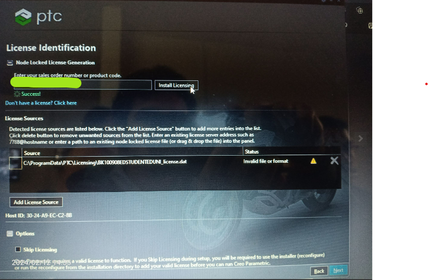

Creo 10.0 Installation error
TG_10951998
2-Explorer
Creo 10.0 ....while installing software i am stuck in step 2 ....even after I entered correct sales order number it is showing invalid file format .....how to solve this problem? 
1 REPLY 1
it looks like PTC license generator is not able to generate valid license file for MartinHanak_0-1707739553949.png.
Please open Command prompt window, run ipconfig /all > ip.txt command and upload ip.txt file.
