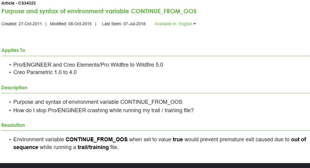

There is/used to be a config option for suppressing out of sequence failures for trail files:
continue_from_oos true
Apparently that is long gone. Now one is reduced to (from Olaf Corent site)
set_trail_single_step no,yes
I believe this is not true.  PTC's site has an article that says it's relevant from Creo 1- 4.
Purpose and syntax of environment variable CONTINUE_FROM_OOS
https://www.ptc.com/en/support/article?n=CS34323
