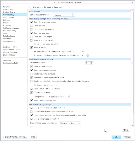

If you can't see the real time render settings under the model display options then you don't have the license for ambient occlusion.

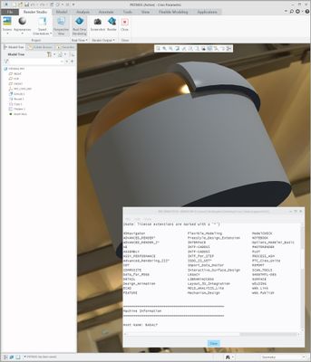

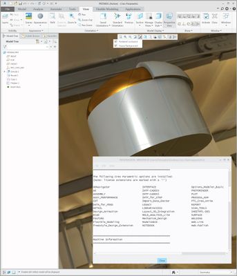

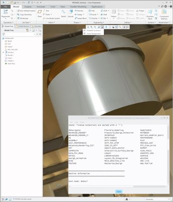

Check if your license includes:
# Optional Modules = PHOTORENDER
This option is NOT advanced render studio.  It's a part of the license for, Creo Essentials (at least it is on my machine)
I launched a session of Creo without the ARX (Render Studio eXtension, not to be confused with Creo Render Studio - which is a standalone app and requires a separate license... and PTC support informed me that there is no extra functionality in Creo Render Studio.
If your license does not contain "Photorender" then perhaps I have it as a legacy thing.  I've had this license for AGES!  So even without ARX, Creo still shows ambient occlusion and shading with reflections *(aka real-time rendering)
I hope this helps.
PS> Here's what I have with and without the ARX included on launch:
Without ARX, with Ambient Occlusion, and Shading with Reflections turned on.
Without ARX
With ARX, with Ambient Occlusion, and Shading with Reflections turned on (looks the same)
With ARX And lastly with ARX turned on and using Keyshot (without changing view)
 ARX - Actually being used
