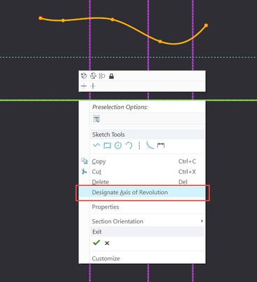

Select the axis - right mouse button and press "Designate axis of revolution".2018-03-07_15-26-58.jpg

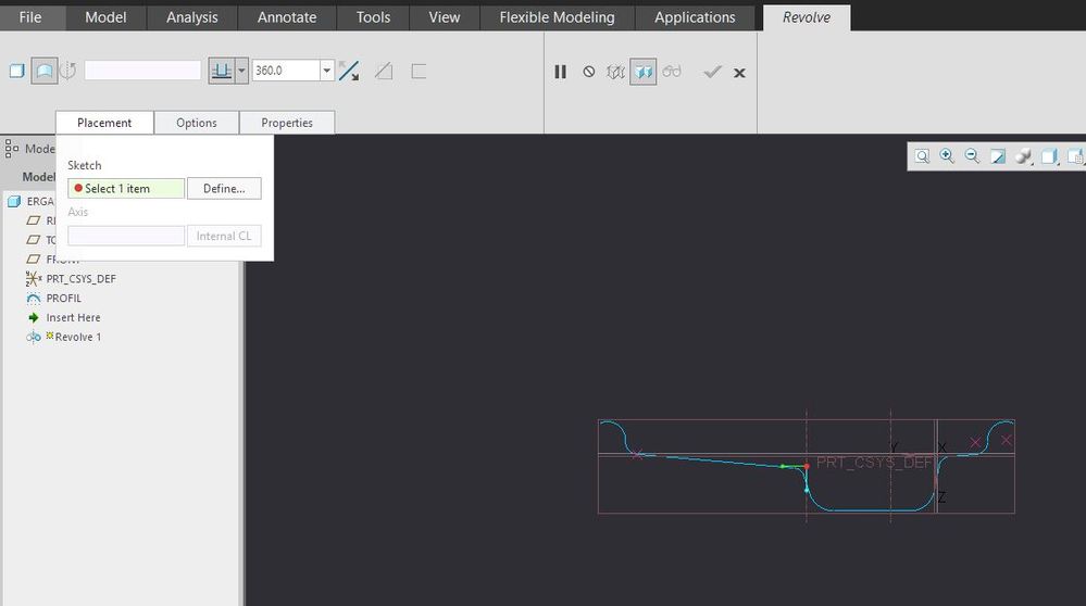

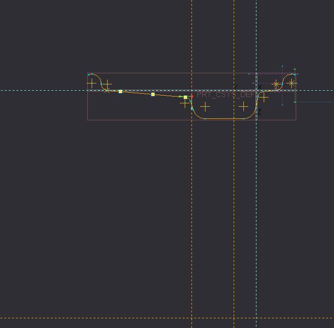

I want to revolve it around the horizontal axis ( the one which does not intercept the sketch) but when I select revolve feature , I get what you see in the second image wihtout being able to choose anything else exept a new sketch in a revolve tab
in thw sketch tabin thw sketch tabrevolve settingsrevolve settings
As per images, there is no possible axis for revolve hence getting stuck. If you will create an axis prior profile Sketch, it will allow revolve.
MaheshSh, the wanted axis of revolution was the orange horizontal line , at the first image , the one near the down edge of the image

There are 2 ways to do it:
1.  Create a centerline in your sketch, and set it as the Axis of Revolution (highlight then Right mouse button).
2.  Have a datum axis created prior to your sketch, and use that.  Also, ALL entities must be on one side of the Axis.
...and remember that there are geometry axes and construction axes.
If you can, use one geometry axis for the true axis of rotation within the sketch and any required subsequent axes should be construction axes.
